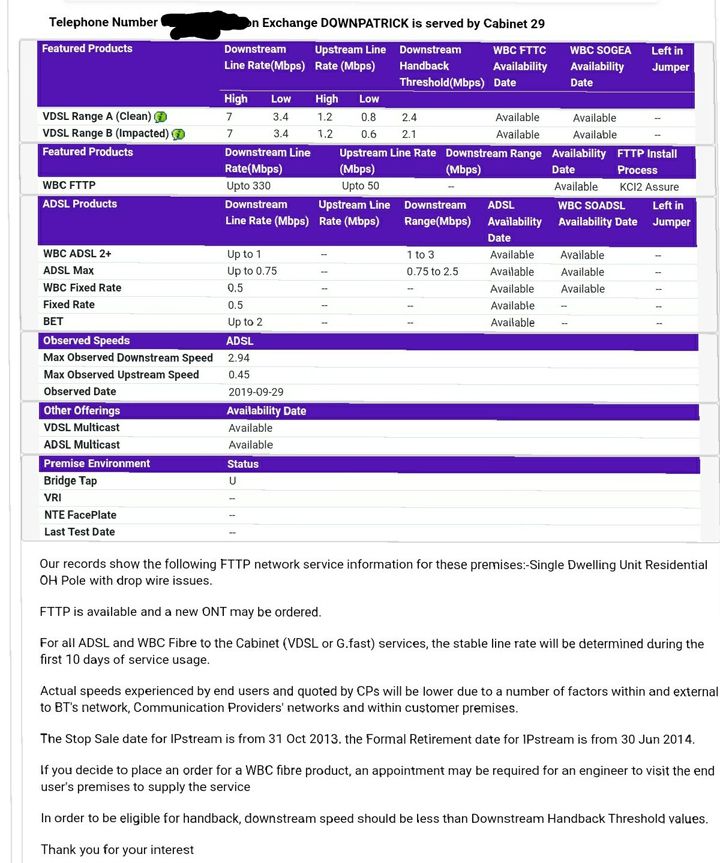

Hello,  thank you both - here are the results,  I haven't the foggiest what any of them mean,  so a translation would be very much appreciated. Not sure if this is relevant,  but we have quite a few tall trees around our cottage and a pole in the lower part of the garden - engineers have been out to fiddle with it a few times over the years.

I hope the attached pic is viewable - I tried copying and pasting the table,  but got an error message over invalid html characters or something.  Out of my depth.  😬

Picture viewable fine.
Ok, because both FTTP and FTTC are available its not clear what your upgrade will be. You must be a long way from both your exchange and cabinet for the speeds quoted in the checker. I suspect the upgrade will be to FTTC which might give you a very small increase in speed but nothing spectacular, you are currently getting around 3Mbs with your current ADSL and might get around 7Mbs with  a following wind with FTTC. Under normal circumstances, I would recommend that you order an upgrade to FTTP to give you up to 330Mbs but that would involve an engineer visit.
As far as the current situation is concerned, as stated, I'm not sure what will happen.  At a guess, when you enquired about upgrading you were given information pertinent to FTTP but the letter you received is pertinent to FTTC. If the upgrade is to FTTC, no engineer visit will be required, if FTTP, a visit will be required. Hope that all makes sense.
I think the only thing you can do is call again and ask if the upgrade is to FTTP or FTTC. If you can't get a sensible answ er from the helpdesk, post back and we'll see if the mods can shed any light. They are very busy at the moment though.

Your picture has posted fine and it say FTTP ( Fibre To The Premises ) is available

Thank you licquorice and pompey.  I did ask the live chat folks specifically about FTTC ( I believe that's what the Fibre 1 package I was hoping to get entailed)  and they seemed quite adamant that an engineer would need access to the house.  The operator on the helpline was a little unclear precisely which type I was meant to be getting, but she said she was confident that all I'd need to do would be plug in the hub and I'd be up and running. Can you see any clear indication on the chart showing that my actual home address has all it needs at the moment for FTTC?  It's all Greek to me.
The hub is due in a couple of weeks,  I think, but even if I get it working with my current set-up,  that won't give me any indication what will happen on July 17th when copper broadband is switched off,  will it?
We find we're able to stream okay from Amazon Prime on our current broadband,  slow as it is,  it's very stable.  Sorry to pester you with daft questions,  but would the 'upgrade' be as reliable and stable?  If the increased speed isn't significant and not even guaranteed,  would it be wiser to call and ask to opt out,  considering how crucial our internet connection is to us in lockdown?

If the changeover is to FTTC, it will simply be a case of changing over the hub as soon as you get it as it will work with both your existing service and FTTC. In fact if you have a Home Hub 5 or later you won't even need to swap it out, you can just use your existing hub. With the distance you are from the cabinet, it is possible that ADSL is a more stable service but BT will be switching it off at some point.
Obviously the choice is yours, but I would consider perhaps asking if the upgrade can be cancelled, if you are relatively happy with your current service, and then upgrade to FTTP at some time in the future when an engineer visit is acceptable.

Sorry to be such a dolt,  but I don't know how far we are from 'cabinet 29' - is it likely to be somewhere along our road,  or nearer to the closest village (about 4 miles away)?  Why might the FTTC be less stable? I'm afraid I have no clue how it all works,  but I thought that if an engineer wasn't needed then the same cables must be used? Do you know if the trees in our garden are more likely to interfere with the new set-up than with the ADSL?
I'm just worried that our internet might drop out entirely and we'd be kind of lost without it right now. Are customers in rural areas more prone to unstable FTTC?
