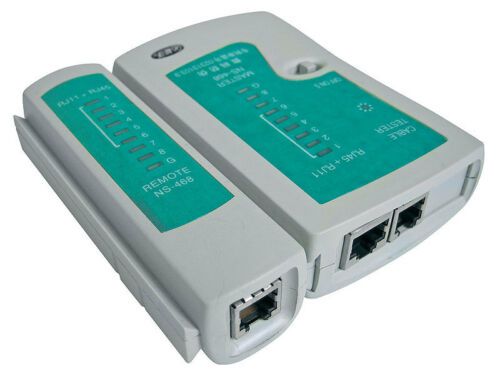

@Kevpen102  What have you tested it with? One of these is less than £10 form a well known auction site and tell you if it's wired correctly. I assume this is what @Starwire  was referring to.

Re: WAN Cable length
Pretty sure that’s the one I’ve got. Not used it for a while as we seldom need to do Data Cabling.

Hi Starwire,
yes, that looks like the one I have. Just to check, it should be wired pin to pin, right (1-1, 2-2, etc...) and not as a cross-over cable.?
