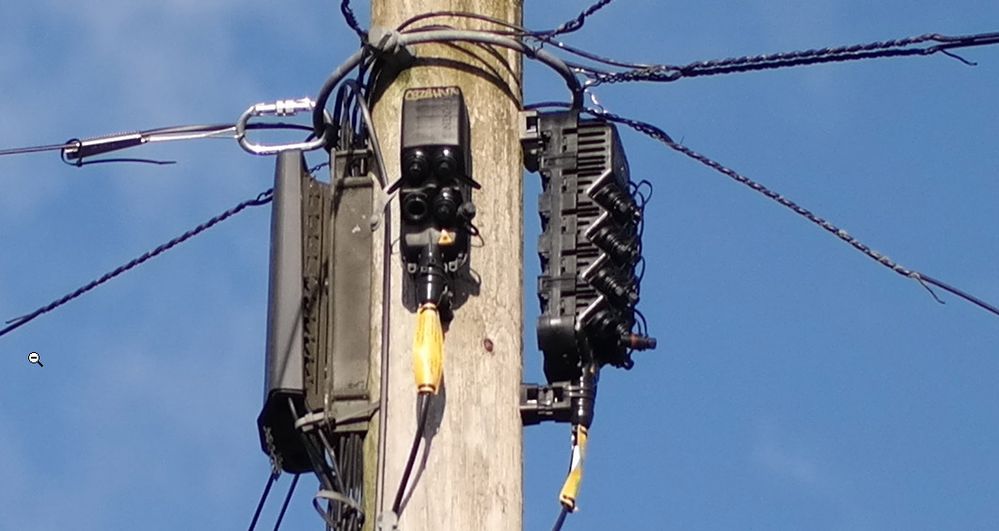

Hi everyone can so.einetellme what the 2 bits of kit are in this photo?  Is the stuff on the right what will connect to the property?

Also if this pole is outside my property can fibre be connected?

That’s a Fibre Node. Possibly a Splitter but most likely just a Track Joint.
Ref to you being able to get FTTP, depends what that joints there for.
Is there any other furniture at the top of the Pole, specifically a black box that looks like an upside down egg box?

On the left looks like a joint box on right a CBT for fibre. Once it goes live you should be able to order.

Can’t remember it’s technical name as it’s not something I would ever fit.
Its basically to secure the 12 or 36 fibre cable to the pole. It wraps around it in a figure of 8 configuration.

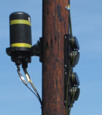

Thanks for that @Starwire  I've found a pick of the CBT for the OP (CBT on right).

I believe it's FTTP
Did you take the photo yourself or get it off the internet? it's remarkably like this one which carries a brief explanation.
https://www.westlittleton.com/FastBroadband.php

2 CBT’s. A 4 Port and a 12 Port.
They always put in enough Ports for each property served. Although I don’t see many existing Drop Cables from that BT76 so unsure if it theres even 16 Working Coppers Circuits off it?

Hi all thanks for the replies very helpful.
The image is a stock image as it looks exactly like what I can see but its a good close up.
I've attached the actual pole picture.
There is nothing else like the upside down egg box.
So I guess I'm wondering can this pole supply my house?

It cannot as yet.
