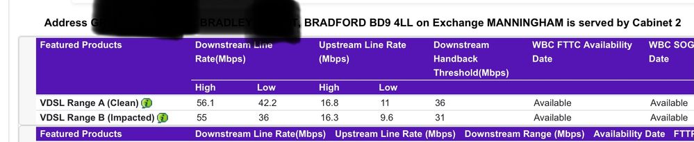

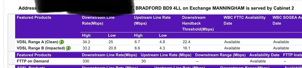

Hi all.
Had a look at at the wholesale checker and we’re on the same exchange and cabinet.
Our speed is about 22-24, which is not good enough for 4K 😭09B0C1CD-D7E1-4C36-811F-5685BD3FC072.jpegDAB63403-7E75-4238-B1FE-BD8CEDBAB8F6.jpeg
Anyone I can talk to to get the same?

They’re just Estimated Speed Ranges and not indicative of the speeds they actually get.
If they are getting those speeds though the reasons could be because of a number of factors.
Although off the same PCP you may not be on the same DP and the cables for both have a different cable gauge and follow completely different routes to the cab, i.e. one could be a lot longer than the other.
Also could be down to internal factors with say your wiring. You could have 56mbps coming in at the NTE but lose 20+mbps over an extension cable.
