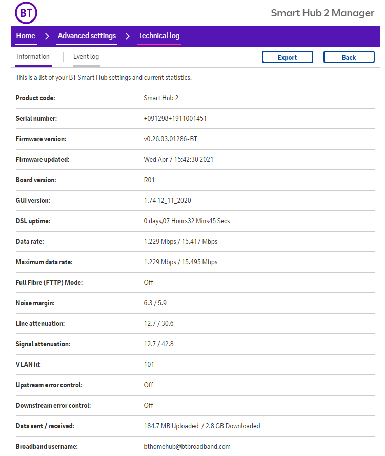

Can you post the hub connection stats again? Just the information page.

Yesterday BT said the second line engineer had escalated the case to have the cables in the corridor box replaced today, and that Openreach were just waiting for my landlord to give permission (who also gave me the okay). Of course what actually happened was a third lone line engineer came and said none of that was ever going to happen, and suddenly the cables both prior line engineers had called old and filled with errors are "fine." Problem, of course, is persisting. BT clueless and just talk in circles when I phoned them in confusion.
