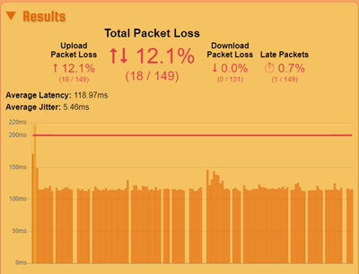

Re: Zero Upload Speed
Using packetlosstest.com I get the following results:-
