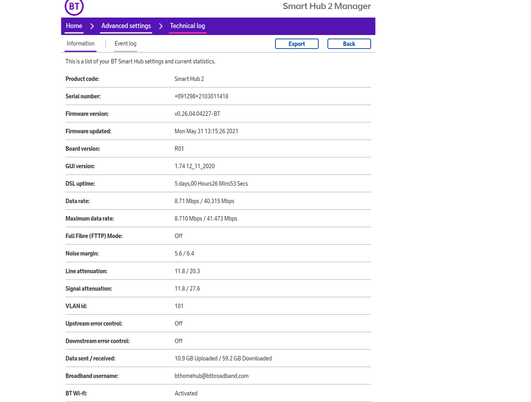

I JUST POSTED MY HUB STATS ..AS I DONT TRUST THE BT CHECKER...

your stats show you have a 40/8mb connection speed with and max attainable of 41/8 and noise margin about normal 6db
without dslchecker info you are getting as good as your line can handle
