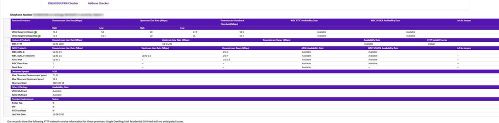

Re: fttp question
This was rather fast process overall
