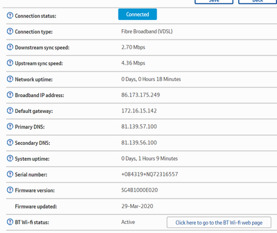

Hi, For 3 days I have unstable broadband and when it is on I have 10% of my contractual speed. I have tried the BT test my speed tool but nothing really happened... I do not think it is a good tool at all, to be honest... Did someone have the same issue as me I am in the Christchurch-Highcliffe area BH23. My contracttual speed is 21Mbps mini and I have 2.7... while usually I have 27.... Thanks

post the hub stats  advanced settings then technical log information

Where can I find the hub stat ? I found the log as it is clearly stated on the advanced setting page.
i cannot send them at the moment as my hub keep resetting...

Advanced settings/technical log/information.
