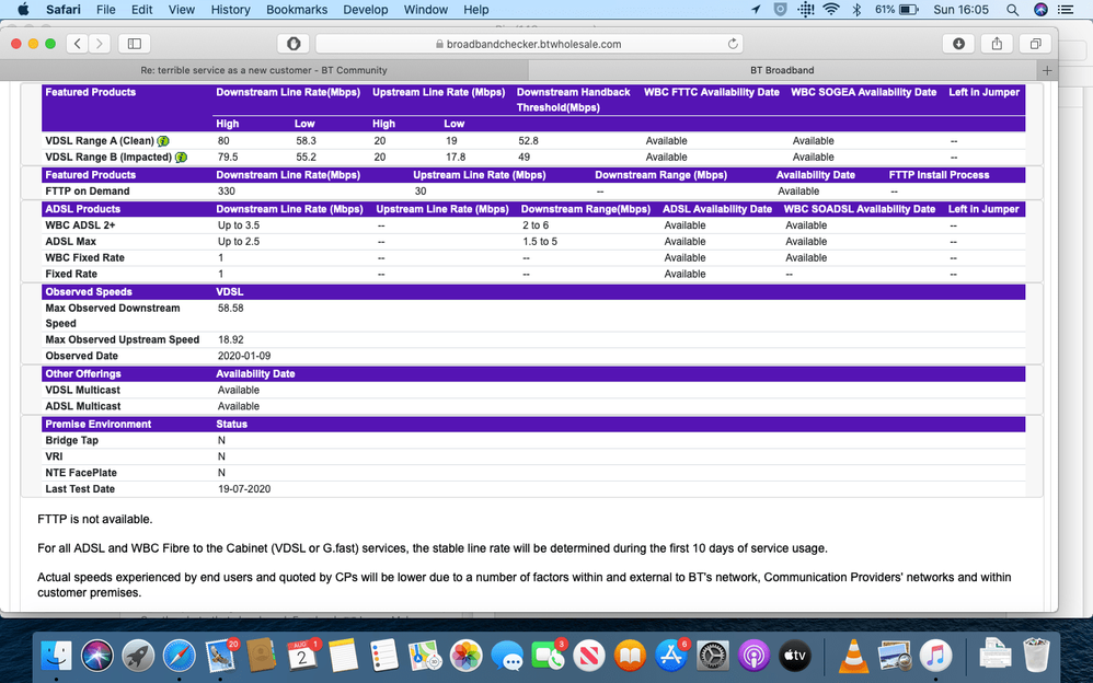

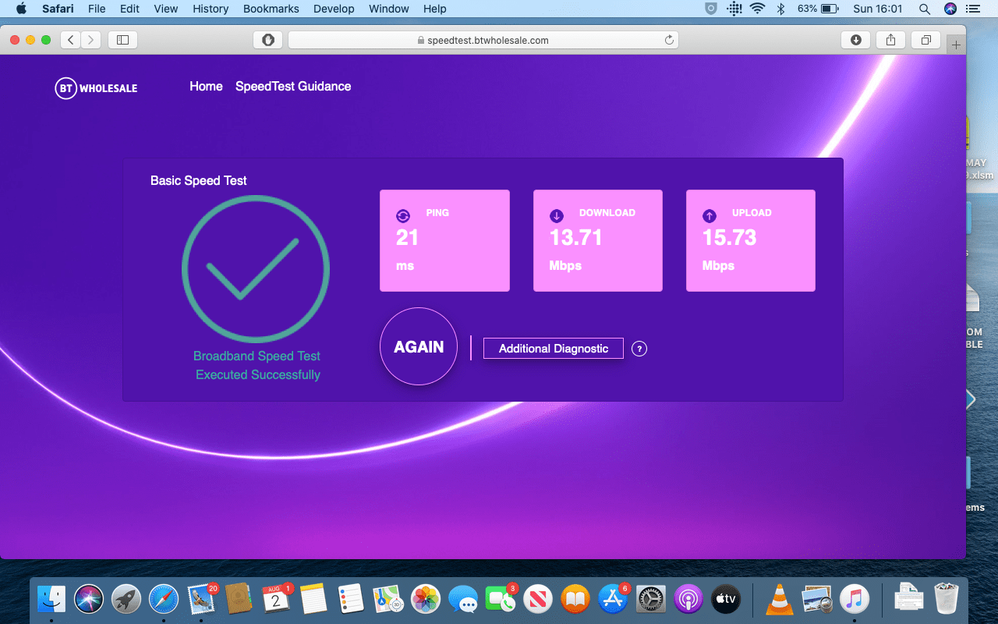

Re: terrible service as a new customer
Screenshot 2020-08-01 at 20.52.31-min.pngScreenshot 2020-08-02 at 16.01.52-min.pngScreenshot 2020-08-02 at 16.02.25-min.pngScreenshot 2020-08-02 at 16.05.40-min.png
Tags (1)
4,893 Views
Message 10 of 21
From dslchecker your last recorded connection speed was right at bottom of your estimated range but really need to see stats to see if that is as good as you get or attainable is much better
which exchange and cab are you on as you deleted that from checker results
