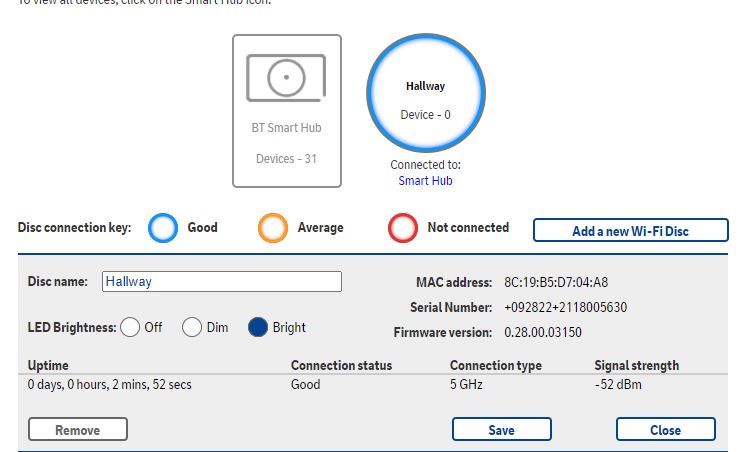

I have just set up a black disc as a test and as you have said the Disc can still join to the Hub as it uses the backhaul network.
However the Hub & Disc are completely useless because I have WiFI disabled, so the SSID on both radios is blank

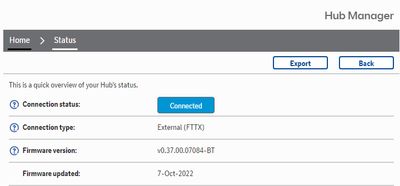

It appears that my hub had a firmware update on 7th October 2022Yoz_0-1667085464311.png

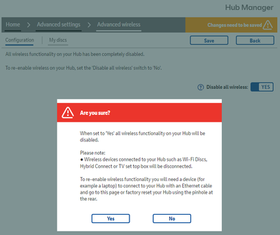

Selecting the option to disable, provides warnings of devices that could be affectedYoz_2-1667085591297.png

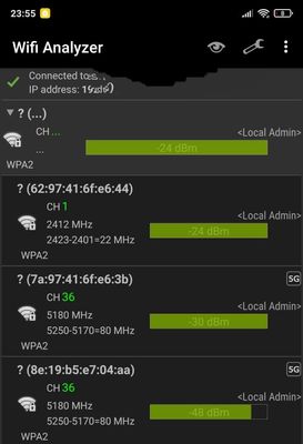

I can confirm using the same WiFi scanner software I used previously, I no longer see the unnamed SSID.
