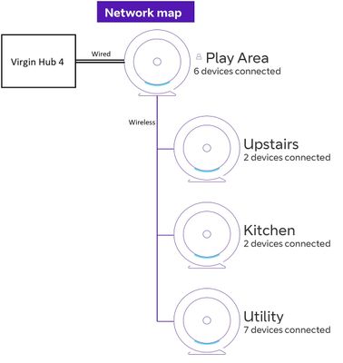

Hi Guys,
I've been debating whether I should post this or not but after months of trial and error, reading other topics in the forum and getting help from BT email/helpdesk, I decided I have no choice but to reach out.
Problem:
Whole Home Wifi discs disconnecting every few days. All discs (apart form the one connected directly to the main router "Play Area") disconnects every few days.
Set Up:
Product type: WHW1
App version: 3.14.8
Operating system: iOS 15.3.1
Disc firmware version: v1.02.13 build07
Number of discs: 4
Observations and Steps Completed so far:
  • The only observation I can barely say I've noticed is that the disconnection APPEAR to happen after few hours of no direct network activity,  e.g. sometimes in the morning when i wake up, or when i come back home after a few hours during the day. I said no direct network activity because I'm sure some of the devices connected to the network will still use it even though i may be sleep. for example Ring Doorbell, NEST thermostat etc..
  • When the disconnection happens the effected disc has a red light and shows as disconnected in the app. Strange thing though when i click on the "troubleshoot" button for the effected disc in the app as im going through the steps i get a quick pop-up saying "Connection Restored". But that's a lie as it still has its red light on and shows as disconnected. this step can be repeated with the same outcome.
  • When the disconnection happens the only way to fix it is by either:
    • physically going around and switch each disc off (including the main) and switch them back on after a few mins, (restarting the effected disc on its own doesnt solve the issue), or:
    • using the restart button from the app (which i believe it just does the same steps as above)
  • When the disconnection happens the other discs (and the main Virgin hub) still work correctly.
  • All discs show excellent connections when working correctly and their line of sights are not obstructed nor too far away from each other.
  • I've replaced the ethernet cable on the main router and also changed the ethernet port on the virgin hub. no impact.
  • I've now added a smart plug to the main router to set up a routine to restart the network once a week (middle of the night). This step didnt seem to have any impact.
  • Contacted BT help desk on the phone and I received the following response from [email protected] to try:
    • Enabling the "compatibility mode" setting from the router main page. tried this and at first i thought this had fixed it but the problem reoccurred after a week or two again.
    • Disabling the  "legacy steering" setting. tried this method and this didnt have any impact either.
    • Reset each disc individually. tried this also and no impact either.
Appreciate your time reading this. Let me know if there is anything else i could try as this is getting very frustrating.
Thanks
@SeanD @JohnC2 @Dan-O @NeilO
