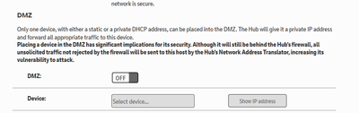

Use the R7000 as a router and put its IP address in the DMZ for the BT Hub.
Hub Manager > Home > Advanced settings > Firewall

Based on previous messages in this place, here is what worked for me on a Netgear MK93 system:
  • Connect to the GUI in the Homehub
  • Backup your settings
    • Advanced settings
    • Backup / Restore
  • Advanced settings
    • My Networks
    • IPv4 configuration
  • Assign the Homehub an IP address (I used 192.168.2.1) that does not clash with my Netgear router's default (192.168.1.1) with all of its reserved IP addresses
  • Reboot Homehub
  • Set Netgear in router mode with IP address 192.168.1.1. (That is the default.)
  • Connect Netgear router WAN port to LAN port on Homehub
  • Reboot whole network
  • Get into GUI for Homehub with GUI and 192.168.2.1
  • Look for DMZ setting
    • Advanced settings
    • Firewall
    • Configuration
    • Show device
    • Enter IP address that Homehub has allocated to Netgear router
  • Reboot again if necessary (it wasn't here)
    • Advanced settings
    • Backup / Restore
There may be other ways of getting to the same destination, and all the reboots maybe overkill.
The end result is a Homehub that passes traffic on to the Netgear router. Everything is plugged into the Netgear or into a switch connected to the Netgear.
I can still access the Homehub at 192.168.2.1 and the Netgear router at 192.168.1.1.
Now when BTEE forces Digital Voice on us I should still have a phone connection.
