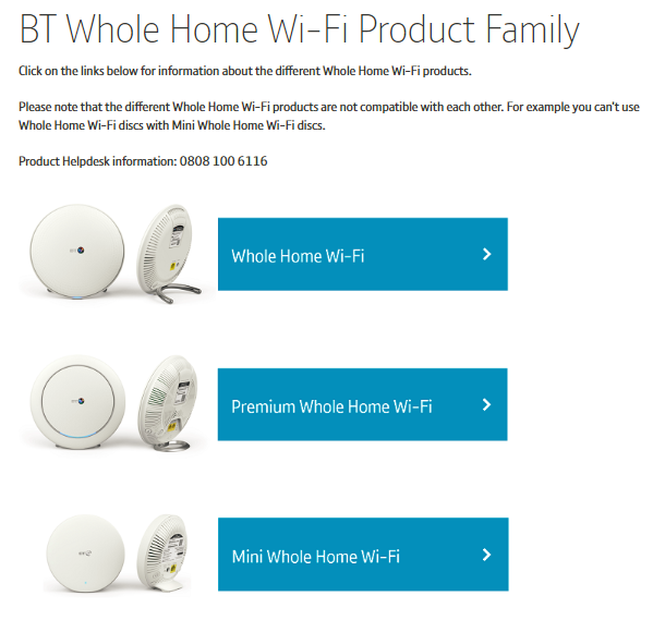

This is a post for BT Whole Home Wi-Fi, Mini Whole Home Wi-Fi and Premium Whole Home Wi-Fi (white discs).
If your problem is with Complete Wi-Fi and Smart Hub 2 (black discs), then see and post, Introducing Complete Wi-Fi from BT, where the right people will be able to help you; the two systems are different and not compatible and use different apps (Complete Wi-Fi uses the MyBT app).

7. Where to get more help?
You can find further assistance on the WHW product family landing page on bt.com/wholehomewifi.
