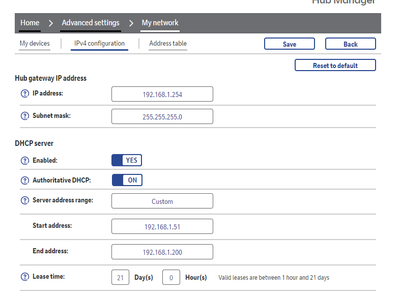

The BT SmartHub 2 only has a max lease time or 21 days.  You can find this under Home/IPv4/AddressTable as shown below.
I have mine set at 21 days and although this works for a period of time, once the 21 days ends i have heaps of issues.
The other option is the you can run a NAS box with DHCP and use that as may give you infinite DHCP or perhaps run a small server.  But that really depends how familiar you are with IT.
