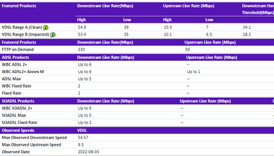

My neighbour and I are connected through the same pole, to the same cabinet. We're both on Fibre1. My neighbour uses a BT H3 and I use a non BT modem/router - although I do have a BT SH2.
I have a good connection - max observed speed 54.57/9.5

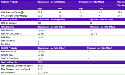

My neighbour doesn't 34.99/1.17 - although when I looked a few days ago, the max observed speeds were 24.99/6.65
My neighbours line is quiet (performed a quiet line test); there is nothing apart from a wireless base station and HH3 connected to the master socket - no other internal wiring. We have discussed the speed with the BT fault team and we've been told everything is fine. A non Openreach engineer will visit in a couple of weeks to look at the inside of the house - but I don't think this will resolve the issue.
The HH3 logs show many resyncs and HH3 restarts. My theory, is for some reason there is an "issue" - hence the resyncs, and after the HH3 sees so many resyncs within a certain time frame, it reboots itself. All these “loss of connection” events have made DLM place a cap on the line - and hence the lower speeds.  The observed speeds ending in ".99" possibly support my theory.
Would my thoughts be reasonable and do you have any suggestions to correct the issue?
