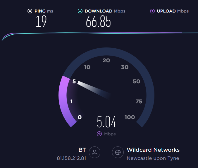

Speeds will vary from 26mbs to sometimes just over 100mbs DL upload will be about 4mbs to 10mbs
But average about 50 - 60 mbs .

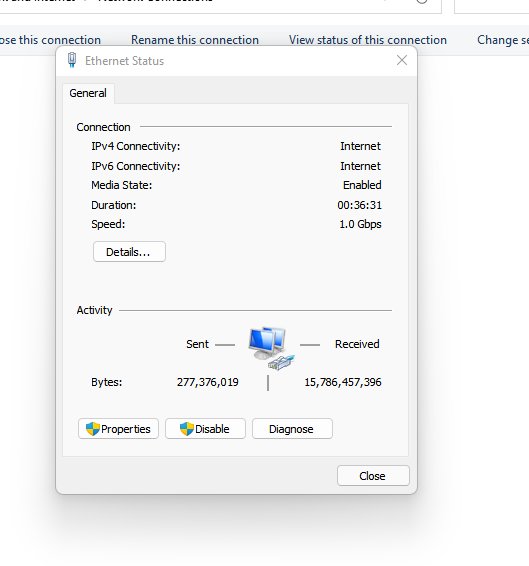

Port is accepting 1gb  and connection shows 1gb . everything is on 1gb and works no issues .

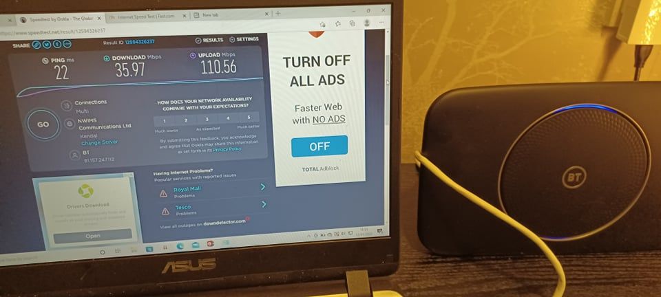

I have also tested direct to router with laptop hard wired and get anything from 50 mbs to over 200mbs . I do expect faster speeds when direct connection to router but im not even getting half the guaranteed this way .

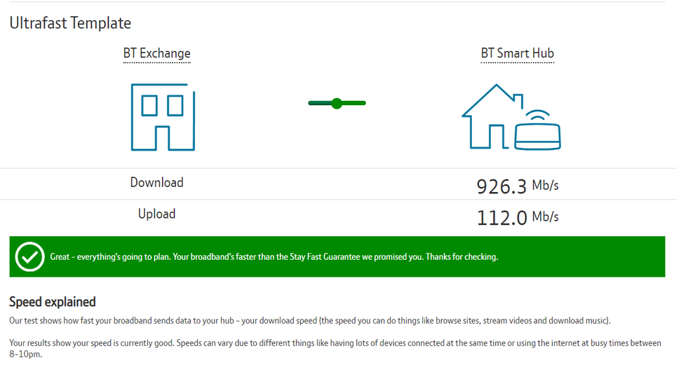

Bt support says im getting 920 to hub which ive tested on app and i am But anything coming out hub is no where even close .

Re: Appalling Full Fibre 900 slow 50MBS

I get no connection direct to ONS
and here is laptop direct to the router
