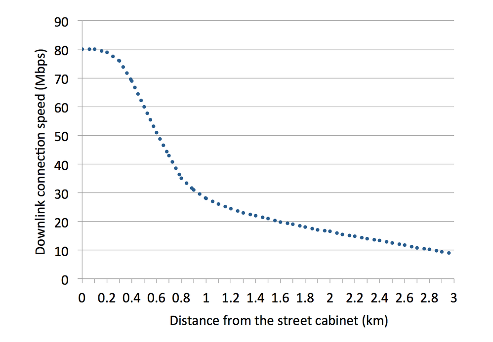

The graph for how speed falls off with distance is a reverse S shape. (You can look up many examples on the internet).
That distance is about where if falls off dramatically, so I am not surprised the speed appears much lower than you might expect.  Unfortunately, FTTC can be a bit hit and miss in that respect.

See graph for what speeds can be expected over distance in ideal conditions with ideal cables/lines. The distance is in km so in miles 0.8miles is 1.3km so your speed in ideal conditions would be about 20Mbps max and that is assuming the cable takes a straight run to the cabinet, which it won't.
