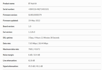

I think this is the hub stats you wanted.

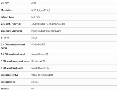

HenryOcho_0-1653983628182.pngHenryOcho_1-1653983678329.pngHenryOcho_2-1653983732529.png

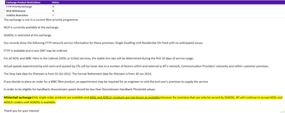

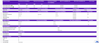

Results of the broadband checker link here.

Unfortunately, your download speed is marginally higher than the handback threshold, however, your line is capable of over 40Mbps but has been reduced by DLM action.
This can take several weeks of stable connection to improve your speed and your line has only had 3 days since the last disconnection.
I would still report the fault and get another engineer visit.
