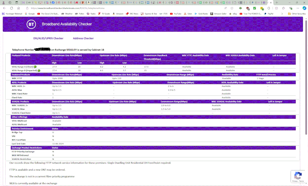

Message 8 of 17
Re: BT Fibre over Copper Cable
Go to solution

Yes I have ordered BT Full Fibre 2 with a speed of 74mb plus digital voice. All I am asking is if they run broadband to my home using the existing copper cable, am I likely to get a reliable speed ?
