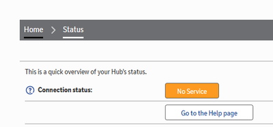

Looking for some advice. I've had the BT full fibre internet service (500Mbps) since May 2022.  Until December 12th 2023 the service has been faultless.  Since December 12th I have had random disconnections from the internet, when this happens the connection status in the Smarthub 2 shows disconnected on the main page:
Internet->status shows "No Service"

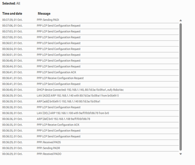

In the Smarthub technical log I see lots of messages as follows:
