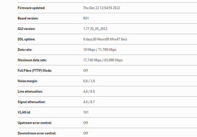

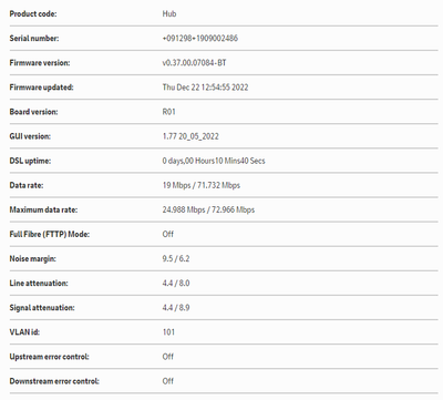

Hi, Just pasting my router stats before anything else.
My broadband has been dropping out since September, and it's been getting progressively worse. (Sometimes 20+ in 1hour in the evenings) I've had several engineers, including 2 open reach engineers who could not find anything wrong when they run there tests. My Smart hub 2 is plugged directly into master socket.
The last Engineer suggested a new router because he thinks there is interference with the Router. I've had the new Smart Hub2 for few weeks and it's still dropping. Some days it can be totally fine, maybe 1-2 drops. Then others it's probably 50+.
The cabinet is basically outside my drive as well so I am very close. Both Engineers said they checked things at the cabinet as well and saw nothing out of the ordinary.
EDIT: It's currently dropping as i wrote this. Managed to capture the following, then it dropped again. Look at the Noise Margin

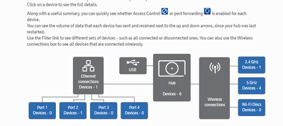

Is the home hub rebooting or just disconnecting?
Its possible for your home network configuration to cause the home hub to reboot or disconnect.
What devices do you have connected to the Ethernet ports on the home hub, are you using any powerline devices?
Look at the event log and see if you can see anything that may be causing this. LAN Up/down messages can indicate issues.
There were also reported issues on some home hubs which were caused by excessive uploads.
Do you know whether the hub disconnects when there are no connected devices?

As I enquired, what do you have connected to the home hub?
Are you using any powerline devices?

Log below from Events when i last disconnected.
But to answer what i have connected,  Nothing fancy, No PoE, Just a few phones and ipads on 5GHZ, 1 Desktop via Ethernet and a TV also on 5G i think

Margin is jumping around the place..
6,418 Views
Message 9 of 21
Re: Broadband Drops 30+ Times per day, multiple engineer visits please help
Go to solution
High resistance fault?
6,393 Views
