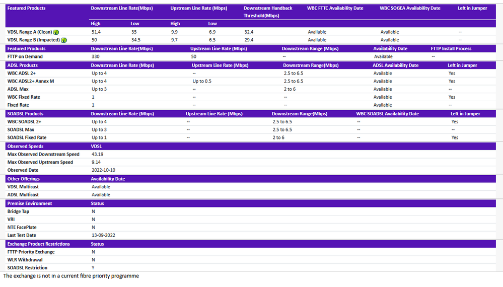

 please can you post the stats from your router (if hub enter 192.168.1.254 in your browser) and if  HH5 then go to troubleshooting then helpdesk and if HH6/SH2 then advanced settings then technical log information .
Have you tried the quiet line test? - dial 17070 option 2 - should hear nothing - best done with a corded phone. if cordless phone you may hear a 'dull hum' which is normal
enter your phone number and post results  remember to delete number   https://www.broadbandchecker.btwholesale.com/#/ADSL
Someone may then be able to offer help/assistance/suggestions to your problem

Hi, quiet line test seems ok, slight hum with cordless phone. Stats:

Re: Broadband Speed Fluctating
Can you please post the full stats as they are more helpful than short version thanks
2,069 Views
Message 5 of 5
Hi, where do i find the full stats? Thanks
