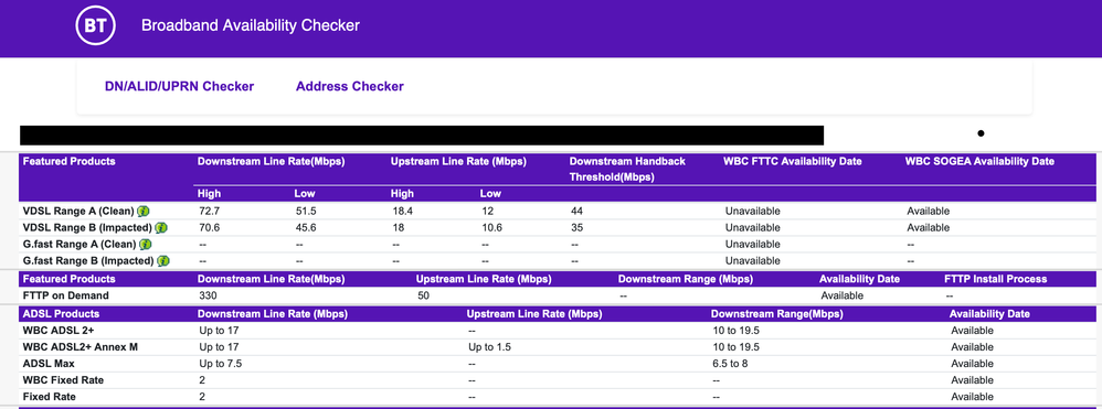

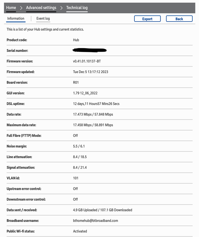

Is anyone able to help my understanding of the potential upload/ download speed improvements for my line?
I currently have Fibre 1 package with digital voice and my download speed averages out at 49 - 52mbps, uploads at around 15mbps (I don't use ethernet).
I am able to upgrade to Fibre 2 for an extra £2 currently, but the details state I should expect to achieve 53mbps download; so barely any difference.
However, if I'm reading it correctly, the Broadband availability checker indicates a potential download speed of around 72mbps. If this is the case, is there any reason why the Fibre 2 contract wouldn't significantly deliver more that 53mbps?

You are currently on fibre 2 and getting the maximum speed your line is capable of (57.8). The checker shows an estimated speed range of between 72.7Mbps and 45.6Mbps. You are within that range.
Moving from fibre 1 to fibre 2 only gives an increase in speed up to the maximum your line is capable of. Had your actual speed been below 55Mbps, it would have had no effect at all had you been on fibre 1 and moved to fibre2.

Are you on FTTC or FTTP
14,109 Views
Message 8 of 8
Re: Broadband Speeds on Fibre 1 vs. Fibre 2
Obviously FTTC if you look at the screenshots in post 1
