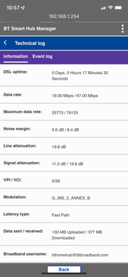

Well, I had a look and indeed noise margin is up.
Just curious, but if I restart the hub will I it retrain and perhaps reduce the margin? How dynamic is DLM?

You need a stable connection for noise margin to reduce. Resetting hub will not help and could make matters worse with higher noise margin and lower speed

Do not be tempted to restart the hub, that will just make things worse.
https://kitz.co.uk/adsl/DLM_system.htm is quite an old description of DLM but gives you an idea of how it works.

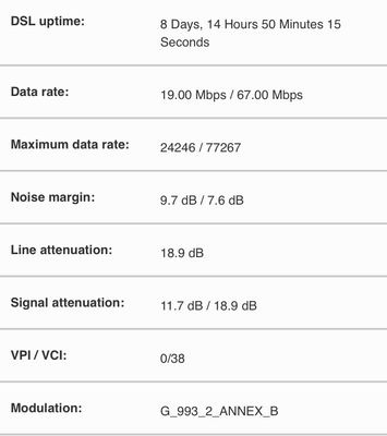

Well @licquorice it may not have been me unplugging the hub a few times after all. That all happened over 4 weeks ago. And today I’ve noticed the noise margin has actually increased. My download speed has  reduced to 52 Mbps (from 75 originally). I had to do the 17070 quiet line just to check again  (from the test socket)  But there’s no obvious crackling / noise. Looking at the logs after about 9 days of  DSL uptime the hub had a soft restart around 1 am. Anyway. I’ve raised a fault but seems odd. Like I say, I’ve had years of stable 75/19Mbps but over the past month or so it’s gradually got worse.

your connection speed is 67mb just as it was when you previously posted hub stats so the recent drop in connection has not change that but your noise margin has increased slightly.  download speed can fluctuate and is not guaranteed
