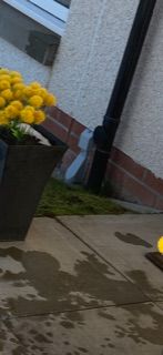

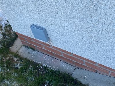

i know it’s a blank socket , that’s what he put over it as it’s not in use.

He installed That cause he said I didn’t have one like my down stairs neighbours. That’s cause I live upstairs and that’s what it is in my cupboard

That’s what my down stairs neighbours have in the street. No one that lives upstairs have these. Is this cause the cables are being run under the floor into the electric cupboard?!  

@Ramsay01 Ok so before you were on fibre to the cabinet (FTTC).
Now you are moving to full fibre which is a fibre cable all the way to your property from the exchange. This is why you now have those two new boxes, outside one is a customer connection point and the inside one is the Openreach ONT that converts the light into electrical signals a router can understand.
Full fibre is the priority product once it's available, which it is to you, hence why you are moving to full fibre as part of the migration to BT Consumer. Your copper line will be ceased which delivered your previous broadband connection (FTTC).
