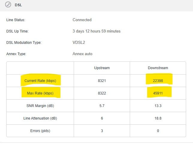

I am not using a BT HUB (don't have one) I am using a TP-Link Archer VR 2100 Router Modem, what data can I pull from it, that might be of interest?

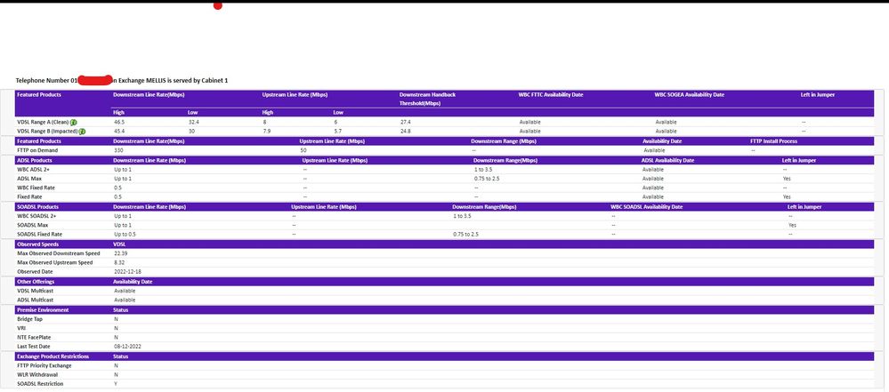

you could post the tplink connection stats page showing actual connection speed , attainable and noise margin.  unfortunately the tplink does not show internet connection time just router uptime.
results from dslchecker link will show what range of connection speed is expected from your connection
