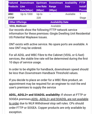

I put my address in and this is what I got

@Callum98
It states a ONT is active. What lights are shown on the ONT? What colour are they?
If the ONT PON light is solid green and the LOS light is off then your full fibre connection is connected to Openreach's headend equipment ok.
If the above is ok then it maybe the authentication with BT Wholesale's  and BT Consumer's equipment. What colour lights are showing on the BT/EE Smart hub?
