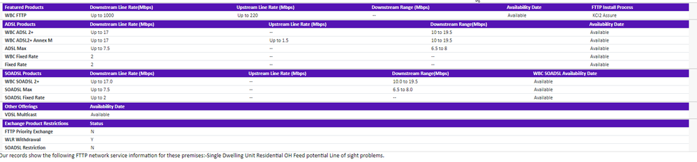

Thanks for reply,
Mine,
Neighbour above me,
I have hidden the addresses, both say that they are provided by Cabinet 10

Re: Converted house, FTTP: Capped at 300Mbps, neighbour above me and receive 900Mbps?
The checker shows both addresses as WBC FTTP 1000, so it’s not the ECI 300/330 Mb issue , and no real reason why providers can’t offer Gb speed that is available , however if  certain ISP’s are not offering this it could their own capacity problem , not an Openreach one, possibly resulting in them onky selling lower speed profiles , but if this 300 limit is across several ISP , some of them ( like Sky/Talk Talk )  likely to be using different backhaul providers to BT  , then it could  be a data mismatch, perhaps it was an  ECI headend that has been replaced with Nokia/Adtran but the  old data remains in the ISP ordering portal.
Unfortunately , how to get that error addressed isn’t likely to be by speaking to the fist line customer service reps that take  orders,  as they probably will only offer what shows up as available on their screen.
