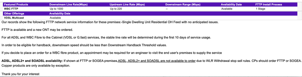

Go to solution

The screenshot is for my house...however I see on the same site that my property is also listed with its incorrect name; this is something specific to BT only and I thought had been resolved some time back.  When we first moved here 11 years, only BT referred to it as 'xxx Cottage' when its long-standing Post Office/council name is 'xxx yyy Cottage'.

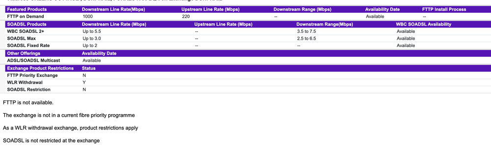

When you put the incorrect name into the site this comes back...Screenshot 2025-08-01 at 07.51.00.png

Although that's the BT Wholesale checker, it's working from the Openreach database. To get this fixed properly you need the old record removing. This needs BT Retail to raise an ORDI request (OpenReach Data Integrity) with Openreach. Your challenge is to find someone at BT who knows what an ORDI is.
The messy way to do it if you're out of contract is to just place a new order against the "wrong" address.
