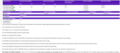

This is what it says when I go to that website:

You do have a ‘partial DIG’ survey note , so excavation is almost certainly needed , so it’s your choice really , you probably have a reasonable estimation of the likely route from the footpath to your house wall , if  you think this route will leave unacceptable ‘scars’ then remaining as you are for as long as you can (even if it’s a little more expensive) is the way to go , but even if it’s possible to avoid FTTP for a year or three , as it’s inevitable , personally I’d take the decision now .
FYI , Openreach have the option, should your directly buried armoured cable go faulty at some point ,  to use the FTTP instead of the avoidable costs of repairing that legacy network, as it  is obvious something of a waste of time and money to repair it  , so your hand could be forced anyway .
