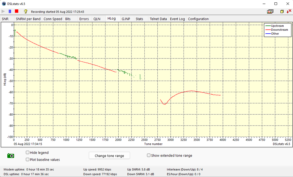

I mentioned the slow upload speed and politely requested they access the HLog on the Exfo tester unit where they found a nasty Bridge Tap, the engineer couldn't work out where this was so suggested he leave for the day and we replace the Smart Hub 2 with a new unit in case that was faulty.
Upon receiving a replacement unit I had the Mod team run another GEA test which came back as a Bridge Tap result, I then removed the phone from the master socket to rule this out and it still came back as a Bridge tap.
As a result of all this a new Engineer visit was raised, a Qube Engineer came out who confirmed that there is no internal wiring within the premises to cause a Bridge Tap, the line enters the house straight from the DP where it comes through the Brick work into the latest Filtered faceplate mastersocket where it feeds the SH2 & a solo landline phone.
The engineer reported back to Openreach that the fault is within their network but ever since I've been stuck in a cancelled engineer loop as I'm assuming all the tests bounce back as fine possibly?
I've even had an unlocked HG612 monitoring the line for an hour the other day to show the Bridge Tap.

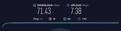

The Stats from the SH2 which I'm currently using show
All this seems to result in a very high ping when uploading, I could do with this solving so I've got the Full bandwidth of the upload in order to access the Farm CCTV when I'm away from the Farm.

After many visits from Openreach the issue has now been resolved, all along the Bridge Tap/Bridged Tap was being caused by a Lightning Protection Joint in the roadway outside the cabinet.
This was tee pieced into quite a few lines and causing issues for other users and not just myself, infact.. three neighbours all now have full upload speeds.
