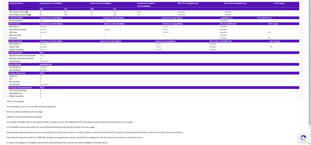

Hello, recently realised my download speed has dropped dramatically. I ran a check on https://www.broadbandchecker.btwholesale.com as below and saw a "Max Observed Downstream Speed" of 46.22mbps, this was previously 67mbps. This speed is now below the shown Downstream Handback Threshold.
When I try and check my options for " upgrading" it now shows I can only choose packages with a maximum of 42mbps which was previously 60mbps+.

I understand that my connection may be lower if there's a line fault, but I didn't think it would affect my predicted speeds, even with other Openreach providers. My neighbours address also shows a lower predicted speed.

You have a line fault, your speed is below the handback threshold so you can report it as a slow speed fault.
