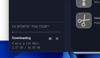

I had similar issues and then ran a program called "TCP Optimizer" picked the top speed and optimal option saved the settings and restarted machine.
I'm using pfsense on N100 hardware as my router.
I was downloading from the EA Servers the other day and it was maxing out my 900Mb line for the whole 52GB download.
Just started another one
