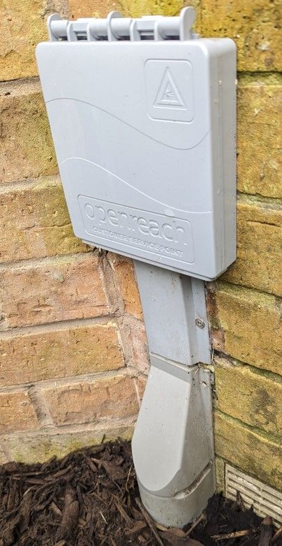

If you find the external junction box where the phone line enters the house there should be a Plastic cover that goes down to the ground, which covers the duct. It should look like the image below.
NB the original BT junction box was where the Openreach box is now.

Hi jam2000
Your property definitely has a duct to the BT Manhole, you can see the plug in the top of it
