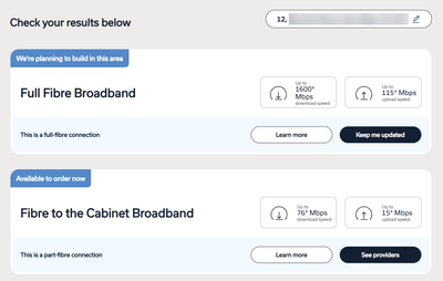

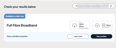

When I use the online checker, it tells me that fibre is not available in my area. Unless I select 'his' house number instead of my own, and then I get an option of 900Mb fibre

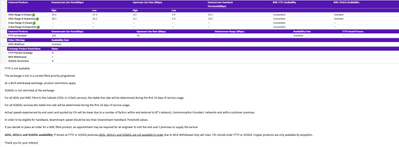

Have you checked what it says on BT's checker, here?:
If you post a screenshot, (removing any personal data, like the location at the top), I'm sure someone will tell you if there is anything amiss in it.
Make sure you include any survey note about FTTP availability at the bottom.

thanks! I have updated my original post with screenshot

I can see the image now.
It says FTTP is not available.  (As I said, "FTTP on Demand" is something different).  I'm not really an expert in this area, there are other on here that are, but it could be something as simple as there being no capacity left on the CBT.  Then again, it could also just be a database error.  Try this and see what it says:
https://www.openreach.com/fibre-checker
Edit: Posting at the same time as iniltous and imjolly.  I'd listen to what iniltous has to say.  He's far more of an expert in this area than I.

Addresses are formatted exactly the same. Both are identical construction, single dwelling (not MDU) semi-detached houses
If I use the checker, I get this for my neighbour at No7, with FTTP and my house at No12, where its unavailable
As I said, the pole is literally at the end of my driveway and I watched the Openreach guys pulling the fibre through, from the box at the end of my road (my house is actually the closest to that box than any other on our road), past my house, to reach his, all the way to his house front wall. This was 18 months ago, but still no sign of it here, despite the fibre splitter being at the end of my driveway!

While waiting for the images to be visible, what about the addresses between you at No.12 and the neighbour with FTTP at No.7 (  that’s assuming the odd and even numbers are all on the same side of the road ) do they all show availability and it’s just your address that doesn’t , or are all or some of No.8 to No.11 showing no FTTP available.
If it’s just your address and especially if your adjoining neighbour (I’m guessing No.11 ) shows FTTP available it’s probably an address data problem and the formwize hopefully will get that corrected , if it’s more nuanced, and (for example) 7 and 8 show available, 9 and 10 show available, but  you and No.11 don’t , ( that’s without knowing that’s these   semis are arranged ) , it could be the boundary happens to be between No10 and No.11 , although that would be unusual, unless a natural boundary exists between 9-10 and 11-12 , like a green (play) area or something like that , which could be the reason for separated PON areas and unfortunately yiu are the wrong side of the boundary….
