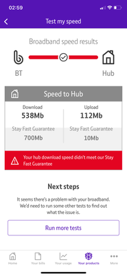

I've just tried the MyBT mobile app speedtest to the hub and this is below the speed guarantee.
I'm just going to try turning the plugs off now and will report back in a day or two to see if things have returned to normal.
