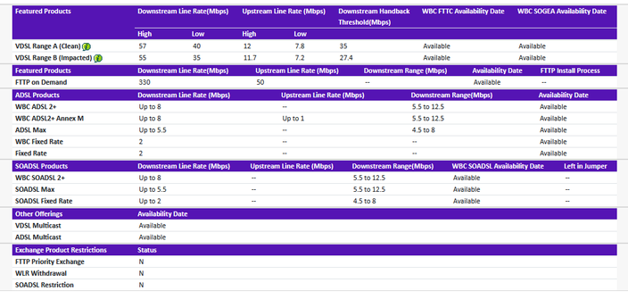

I've checked the broadband checker https://www.broadbandchecker.btwholesale.com and I think it's saying that my line could support up to 57mb. Strangely it says "There is no data available for this number. This could be either because it is not a BT line or it is a new BT number that has just been provided. Most new numbers will appear on the checker 24 hours after BT has installed the line " for my landline, but I get results if I use my address instead.

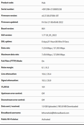

welcome to the BT community forum where customers help customers and only BT employees are the forum mods
please can you post the stats from your router (if hub enter 192.168.1.254 in your browser) and if  HH5 then go to troubleshooting then helpdesk and if HH6/SH2 then advanced settings then technical log information .

Here is my technical log. The uptime is low because I've just had the Openreach engineer here this morning. He seemed to suggest that any decrease from 40mb was due to distance as I am around 600m from the cabinet. On his device it said I was provisioned for 40/10.

Doesn't matter what your line is provisioned for, unfortunately you are getting the best speed your line is capable of achieving.

are you on Digital voice as dslchecker does not work if you have DV
which exchange and cab are you on?
your estimated range is 57/40 with handback at 35mb
