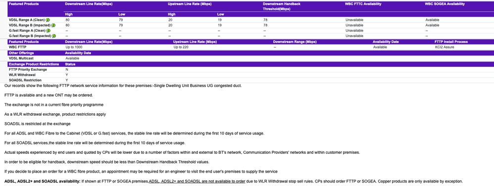

This is a flat above a shop. When I entered my house number , it wouldn't let me add the letter A for our building. without the A is the shop below (shop is 460, we are 460A) so the results below might be for the shop below us

Unfortunately this is getting a little complex , if your address ( the flat with an ‘A’ suffix) doesn’t appear on that checker , then ordering FTTP may be impossible in the short term , the fact it doesn’t show up also is puzzling in that how did the copper service get installed in the first place .
What address shows up on your bill 460 or 460A , and does your address appear on the Royal Mail post coder checker , and is the flat liable for its own council tax etc , as often , especially with flats above shops etc , the flat being rented out was historically something if an ‘off the books’ income for the owner .
In some respects, if you have had a renewal offer , and it’s acceptable (price wise) and it’s only the MSG that worries you, as stated , the MSG isn’t a limit , or imposed on your line , that continues to work exactly as it does now , it’s only if a fault occurred knocking the speed from 70+ Mb  that they may say well the MSG is 34Mb and the line is doing in excess of that .
Depending on how much you wanted to take this , barring in mind the landlord may never agree anyway , you would first need to check the flat is properly registered as a separate dwelling for council tax etc, has its own utility bill for electric, water etc and is visible on the RM website ( this  may be the case ) then approach Openreach to get the address looked at as far as FTTP availability, then it may be possible to order FTTP .
I suspect that way back , the copper service was fitted using the shop address , the installer back then told to put the line in the flat above , things were much more informal back then , today if the address doesn’t appear you would normally get a ‘computer says No’ type response.

As stated , depending on how far you want to go , you could  fill in this Formwize,
https://www.openreach.com/forms/fibre-broadband-availability---customer-form
specifically the section relating to ‘my neighbours can get FTTP but I can’t ‘ , that should prompt Openreach to see why that is , and possibly add the missing addresses ( no guarantee on that though ) when they get back to you  , if your address then appears on the BTw checker then you should be able to order FTTP , but non of that gets around your landlord not agreeing to it installed , and as your original worry wasn’t actually about that but a misunderstanding about minimum speed guarantees , only you  know if it’s worth pursuing , presumably you  and your neighbour flats should be on the BTw site as , Flat 1 460A Whatever St ,  Flat 2, 460A Whatever St , Flat 3 etc , or however they appear on the council tax records and the RM website , it’s worth checking the BTw site for your postcode in case the addresses are in there but in a different format.
