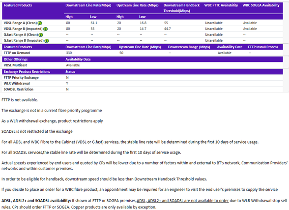

Hello Everybody. I need some help please. We are in the area designated for Project Gigabit New Forest and are currently talking to Wessex Internet who got the contract.  Our houses are 250m from the cabinet currently reached by Fibre and, because our houses were built in the early 1980s, we believe we currently get our broadband (~60mb/s) via a thick cable without any ducting. Note that our private road has no overhead wires at all.
Our broadband checker entry is as follows....
