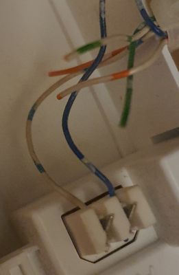

I think I found the problem the farther in law came out and had a look amd I think he made it 10x worse
