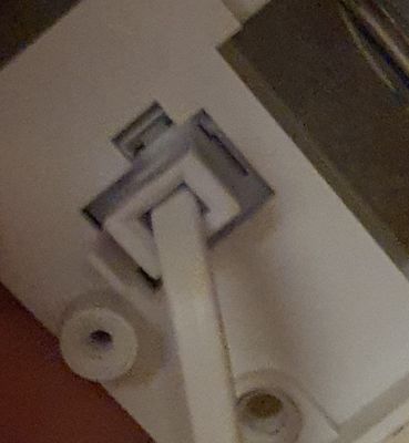

Not clear what that actually shows.  Is it an internal extension connection?  Only two wires are used to deliver the phone/broadband signal anyway.  There are usually a number of "spare" wires that remain unconnected.  That is the case for both the wires coming in from outside and any internal extensions these days.

Oh I didnt know that and regards to the wires it goes from the outside connection thought in inline and then into the hub from the rj11 into the hub that how it runs

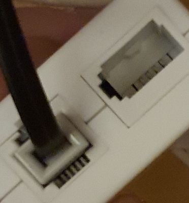

Did you try connecting the RJ11 straight to the top port on the master socket and leaving out the inline filter, as I suggested?

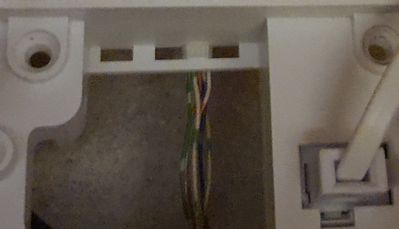

I tired but my socket only lets me put in the inline please see the wall socket

It looks as though the top is removed from the socket in the picture?  Sometimes you do that and plug into the socket at the back to bypass the filtered faceplate to test it but it is not the normal connection method.  If you have socket 6, as you said earlier, there should be two sockets.  An RJ11 at the top and a normal phone socket at the bottom.  The hub connects to the top one.

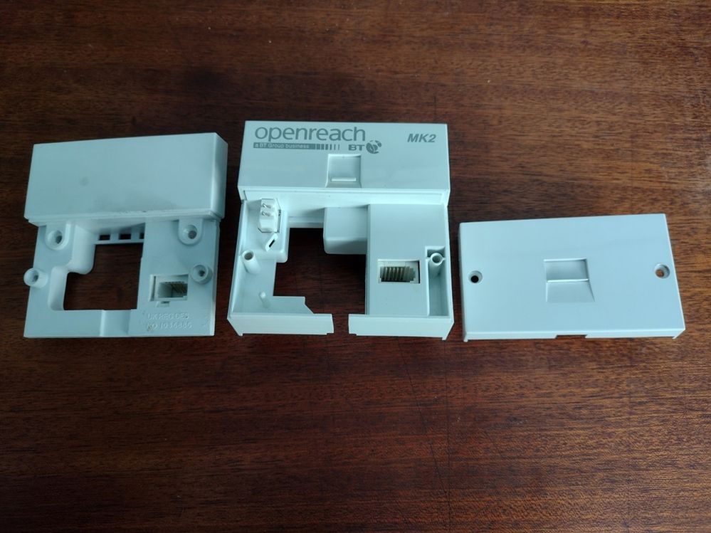

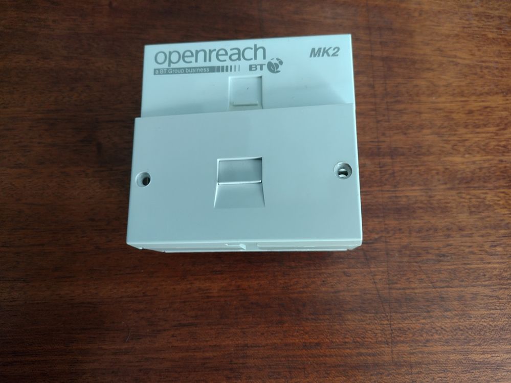

Right.  I've dug out an old type 6, (as imjolly put it), to look at.  What you should have are these three parts:  A backplate (screwed to the wall), a middle filter section with the top socket on it and a bottom part with the phone socket on it.  The assembled unit looks like diagram  6. What you have in the picture is the back part of the socket and the front filter plate seems to be missing.
Strictly speaking connecting it like that should work.  I think the time has come to phone customer services, both because the service appears not to have been activated and because half your socket seems to be missing. They’ll probably need to send an Openreach engineer out to put a new socket in.  (And it's not called an ethernet port, by the way.  If you say that it will just confuse the issue).
Edit: What it should look like is this:Socket parts.jpgAssembled socket.jpg
