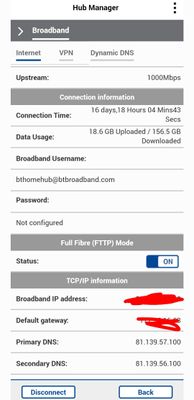

If you want to use the SH2 plug the ONT into LAN4 then go to the web interface at 192.168.1.254 & enable fibre mode. That converts LAN4 to a WAN port.

How do I convert in the manager

http://192.168.1.254 >> advanced settings >> Broadband
Toggle FTTP mode to on

Thank you for that It has solved my problem and not only that by changing the WAN it has increased my upload to 96 Mbps so thanks again
