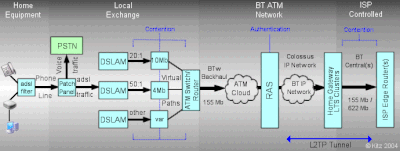

Yes it will be 'exchange' specific due to congestion in the backhaul paths.
This diagram from https://kitz.co.uk/ shows what I mean. It's an old diagram but shows the principles

So you don’t say if you are FTTP or FTTC. Both suffer from Contention, but only FTTC is usually noticeable.
On FTTP each distribution box has a gross bandwidth of about 1.6Gbps I believe. As more houses choose FTTP the likelihood of your speed getting reduced increases, particularly in the evenings.
For the first 18 months of my contract I was consistently getting my full 500Mbps on speedtests. But in the last 6 months all my neighbours seem to have discovered the delights of FTTP (judging by the connections in the pole box) and now my evening speed tests are around 460Mbps.
