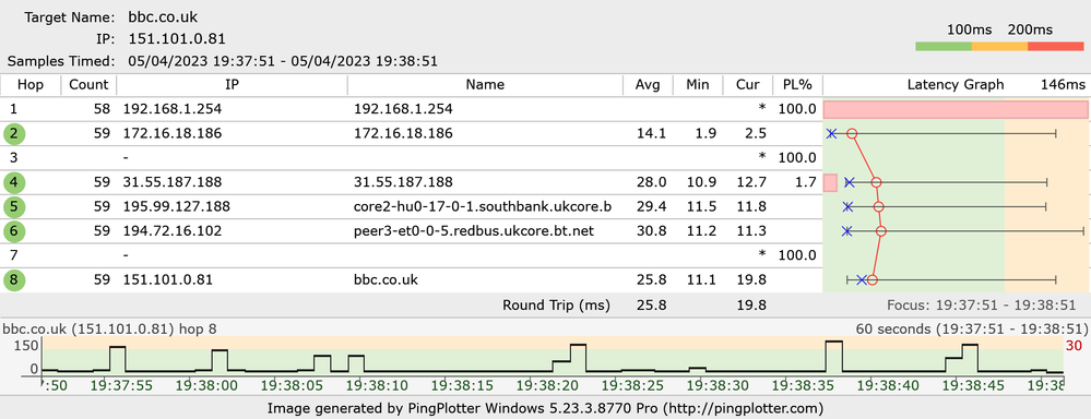

Hi there.
As of late I have had really high ping and packet loss out of nowhere. It is quite consistent. I noticed it start happening after I decided to leave for virgin and they failed to pull the fibre to my house twice where I then cancelled. Could they have damaged some cabelling?bbc.co.uk.pngI've attached my ping plotter results. I have an engineer coming out on Monday but they have done a test and found no issues. I am pulling my hair out I cannot game at all with this ping and packet loss.

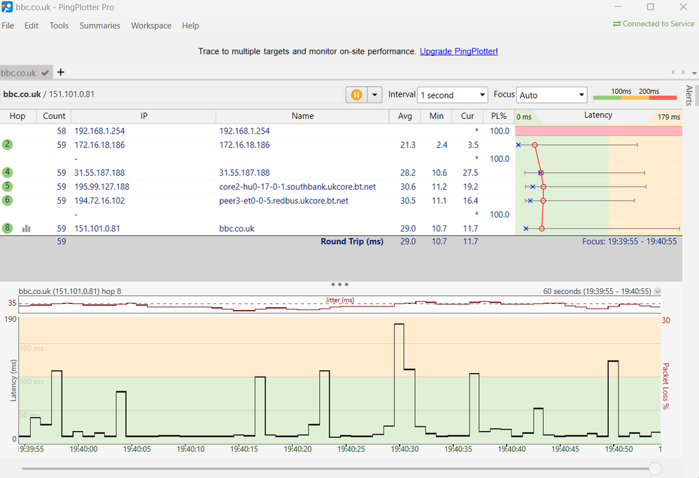

2,915 Views
Message 3 of 7
Re: High ping / packet loss
You have zero packet loss.

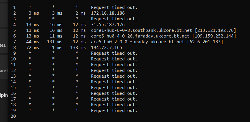

Screenshot 2023-04-06 195926.pngIn this instance yes. I have done a tracert to bt. Could you help diagnose the results?

Request timed out just means the a router is either not to reply to ICMP requests or was too busy doing its job of forwarding packets to the next in line to reply in time.
That would apply to almost all BT routers (including your hub) as BT see it as a security risk.
Going back to your ping plotter always start from the destination which showed 0 packet loss so anything previous was meaningless. You only trace backwards if there is loss at the destination.
