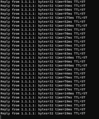

Hello I’ve switched to BT for a few months now the first month was great but since then I’ve had so much problems most times of the day I’m getting high ping spikes jumping from 17ms - 250 to in the 1000ms range, and packet loss, 10-15% and it’s literally unbearable I can’t game at all dropping to around 4mb down, I’ve tried rebooting many times and nothing ever fixes it what is there I can do? Making me wanna switch internet providers again  as I’ve not had the best experience at all
my current plan is 150mb download, 30mb upload

Are you using WiFi or ethernet? Do you also have another device you could run these tests on?
If the same thing occurs on the other devices you might want to try a connection directly to your ONT and bypass your SH2 to rule it out:
Just connect to it with an ethernet cable and create a PPPoE connection with username [email protected] and password BT.

I am WiFi and not that far from it, I have tried it on many devices same outcome, I have tried PPPoE connection on a gaming router which I am currently using and it’s the same outcome.

That's not the same sadly as you are connected to your gaming router via WiFi.
Connecting your laptop/desktop directly to the ONT and running the test will weed out any issues with WiFi and a possible misconfiguration somewhere on your router.
If it still happens when you are directly connected to the ONT, then the problem is BTs.
