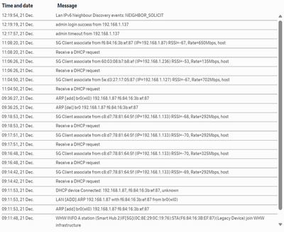

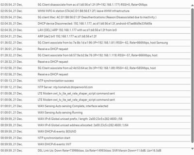

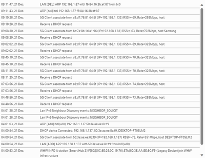

Our HomeHub 2 has been dropping connection quite a lot these last few days. I forced a restart from MyBT which seemed to work until we encountered another restart.
I wonder if any of you experts can see anything untoward in the event log?
Thanks

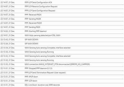

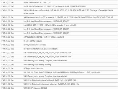

Thanks for the reply. The last disconnect was last night at 10:13pm and was back around 10:15pm. I was surprised to see how large the event log  was around these few minutes. Unfortunately, this portion of the log means little to me and would appreciate any advice if anyone can see a specific reason.
Thanks

It just indicates a loss of incoming broadband signal. It could be a bad connection, or a lot of electrical interference. Older gas boilers tend to cause a lot of interference if the boiler thermostat is worn out. This normally causes interference about every 20 seconds.
It may be worth checking the connections on your master socket, especially if its a 5c type.

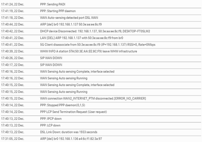

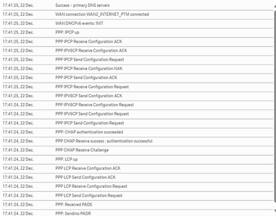

Connection dropped yet again just minutes ago. This was again accompanied by a frenzy of activity in the Event Log.  Plugs checked again - all seem OK.
We're located in a block of flats, 66 apartments, all on FTTC but with a huge assortment of ISPs. I'll ask on the building forum whether anyone has had any disconnects.

Is your master socket located in the apartment?
Normally there will be an internal DP (Distribution Point) somewhere within the building complex which should normally be locked, but Openreach can normally get access from whoever owns the building.
From that DP, there would be a cable to each apartment, terminating in a master socket.
What does your master phone socket look like?
