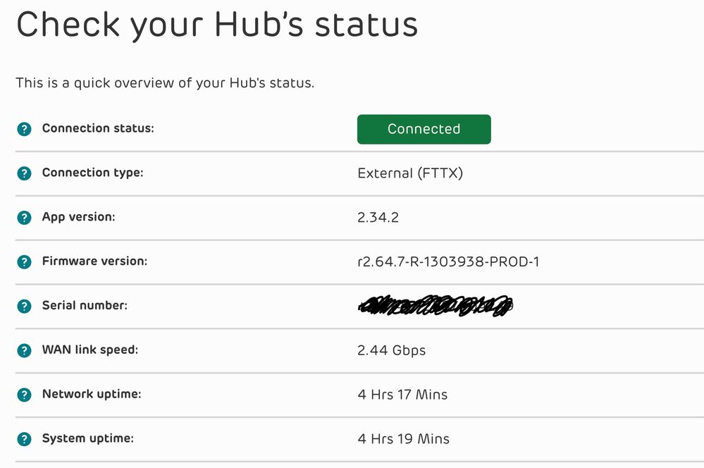

I did ask if this was something to do With the speed coming into the hub not matching the service it should be one gig per second And not 2.44.

I suspect some measurements are getting mis interpreted here ….a GPON system is 2.4Gb download and 1.2Gb upload , that’s the aggregate bandwidth, the way a PON works is all ‘data’ is download data is broadcast to all users simultaneously , so if your neighbours are watching Netflix, and you are watching Amazon Prime , your data arrives at next doors ONT as well as your OBT and their data arrives at your ONT as well as their ONT (times that by upto 30 users download  data  ) , effectively your ONT only responds to the data addressed to you and ignores everyone else’s data  , the same for next doors, their ONT is only interested in their data ,not yours or anyone else’s on the PON .. that’s how Ethernet works ….if you buy a 1Gb profile the ONT limits the rate you receive to that , if next door are on 150Mb their ONT limits their port speed to the appropriate rate but the headend pushes the data out at 2.4Gb max and you see that rate before the ONT  , that’s why your 1Gb service has a guaranteed speed much lower than 1Gb  , if there were 30 customers all intensively downloading and all on 1Gb services , 2400Mb /30 =80 Mb , but statistically that not going to happen plus apart from speed tests download data isn’t consumed in a consistent manner, that how  30 customer on a PON can get the speeds they pay for .
I suspect the 2.4Gb you saw was the aggregate download GPON speed before the port speed limit was applied to your individual service by the headend telling your ONT , you are a  1Gb customer , seeing 2.4Gb is too coincidental not to be the total headend download speed , not your individual port speed set by your ONT

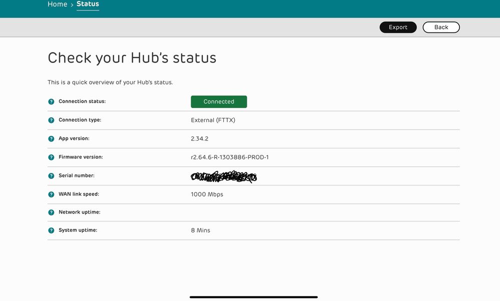

Hi , nit sure if this was a reply  to me as i didn't understand the content as there were acronyms s i don’t understand, but i have some screen shots of the hub before and after ONT’s if that helps as were were changing them  and also the test result cro. The open reach engineers test thats shows the speed mismatch. I cant post that as a phot as it won’t let me drop the size anymore and its too big as a phot so here the text.
it was failing i mediately not after the 5 - 10 minute usul test he told me:
Here are the results of your FTTP test request for OGEA80547872
usingFastTest+.
The outcome was Customers router has negotiated with the
ONT at a lower speed than product. This is either a issue with the router or cable. Please reset the router and retest if the problem is not resolved then replace the Ethernet cable. Please check the connection quality between ONT and Router.
The date and time we processed
thats all i got from photographing his phone, but you get the gist.
