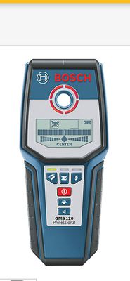

I assume he was using one of these?
When was your house built?
is it a new and or newish build. If so some are built with foil backed insulation, which is perfectly safe to drill into. Do you have any kind of home information pack that would confirm if it is that?
Or it could static electricity, those testers are extremely sensitive. The best way to eliminate static electricity is to put the sensor against the wall and when it starts alarming put your other hand against the wall and if the tester stops alarming it proves it just static.
