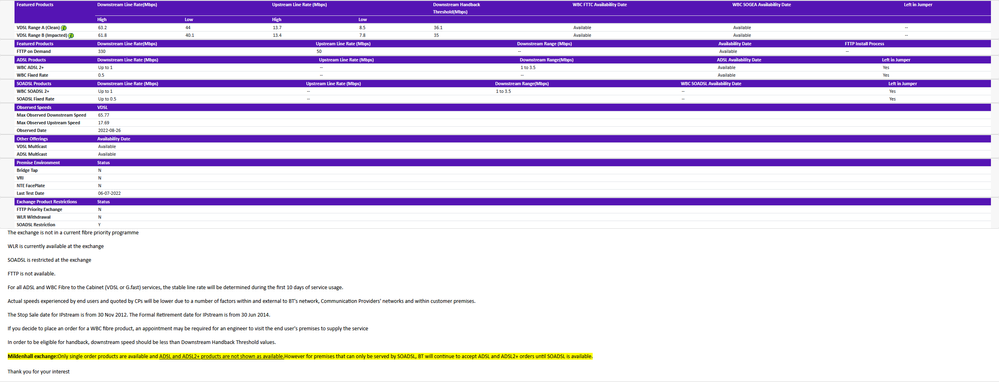

Re: Neighbour 5 metres away has Full Fibre, we don't.
My BroadbandMy Broadband
Neighbour's BroadbandNeighbour's Broadband
Here at both of the availability checker pages. We are indeed an underground serviced area.

As can be seen the DSL return shows that the neighbours already have WBC FTTP and that the  address in question has no FTTP availability….., what’s the orientation of the neighbour, next door ( same pair of semi detached) next door but detached, next door but on a tee junction etc ?, as already stated it’s not impossible for next door neighbours to be allocated to different FTTP networks , only one of which is now built and ready for service , usually there would be some sort of ‘natural’ boundary , so ( for example ) a terrace of 6 houses , looking from the road coukd be served from the right , ‘ next door ‘ is an identical neighbouring terrace of 6 property’s but they are served from the left , so although there  are two end  of terrace properties that are ‘next door’ to each other,  the existing networks are different and don’t converge , so one block of 6 have FTTP , the neighbouring block of 6 doesn’t ( there has to be a boundary somewhere )
TBH, that’s why it’s required to check neighbouring property’s both sides , if either side of someone can get FTTP and the one in the middle cannot , that suggests a database error , otherwise it could simply be you are the wrong side of the FTTP boundary, even if it’s only by 5 metres.

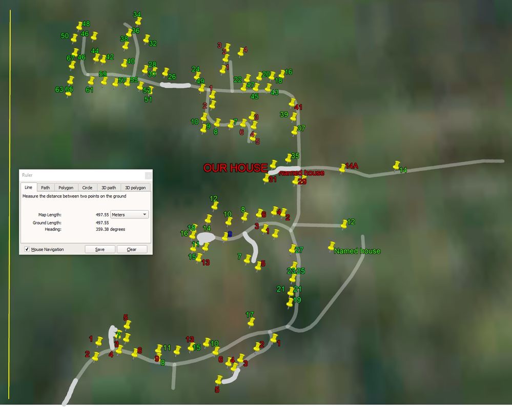

Here is most of our neighbourhood mapped out. Green numbers have FTTP, Red numbers do not. (number 9 is blue because they have the FTTP equipment on their house but Broadband checker says no FTTP). Grey paint is added roads where Google Earth is missing them.

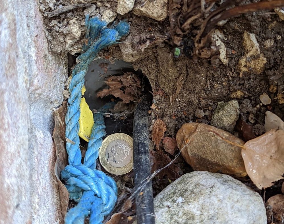

Our are was built in 2000. There is a brick path road instead of pavement connecting the 3 houses in our (not quite) cul-de-sac which was my best guess at why they've ommited our houses. The brick paving does continue as drive-ways but the access brick paving doesn't belong to any individual and nobody. They've also connected other similar cul-de-sac houses with greater distance of brick pathing with FTTP and left houses directly on the main road without FTTP, so it all seems a bit random.
A couple of years ago somebody came to our house and found our tubing for our copper cable (picture), a little while after our neighbour and other households got FTTP while we didn't. So it at least seems like they intended to connect our house and never did.
The houses which have received FTTP now have the original copper cable and a new (presumably fibre optic) cable coming from their tube which feeds into the new Open Reach box on their homesTubing and copper cable - £ for scale. Rope was tied by person who came to find it.Tubing and copper cable - £ for scale. Rope was tied by person who came to find it.

The image shows the duct mouth , that’s good in so far that you have a ducted feed , so no excavation should be required in your garden or footpaths to get you to the ‘jointbox’ where a CBT could be sited that would serve you and probably some  neighbours, so whatever the issues are , it’s not DIG cable related .
Why was the duct roped ?, if an area were surveyed for FTTP  today , it’s noted that the property is ‘ducted’ and would probably be a single stage install ( once the network were built and taking orders ) , they don’t pre-rope ducts to houses in preparation for FTTP , it’s only when an order is raised and the installer on site that the duct is confirmed to be serviceable, but perhaps things were different a year or two ago and they did pre rope ,  your issue is that you cannot order so the existing rope doesn’t indicate your individual property was ever surveyed for FTTP, but doesn’t exclude it either.
The fundamental issue still is , was your small area with an area  surveyed, but never built out with FTTP because of issues such as cost , wayleaves or problems obtaining permissions , or not surveyed because it wasn’t within the scope of the plans that saw your near neighbours get FTTP , obviously is not going to be built out if it was never surveyed, I suspect it were surveyed ( simply because of the close  proximity of addresses that can order FTTP ) but excluded from the build out plan for reasons unknown.
